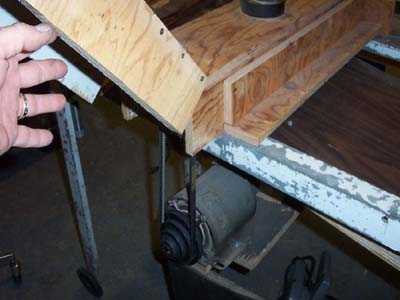

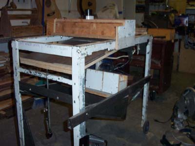

Posts: 552
Hand crank should work great. In some ways, better than a motor brcause you can be sensitive to changes in drag & adjust the feed rate.
That being said, I used a 1/4 HP, 60 - 1 (110 V. AC) reduction gear motor I found on E-Bay for $50.00. IIRC, the output shaft turns 60 RPM. I pulleyed the speed down 2-1.
If you can find a gearmotor which turns fairly slowly, it's simple to pulley the speed up or down to wherever you want it.
There are a lot of inexpensive DC units on Ebay, but you'd need to get a power supply to run them.
It is really nice (and safer)to not have to be busy with the feed as you work. You can quickly ruin a piece of wood if the feed stops while you are sanding.
I am super pleased with my sander & wouldn't trade it for any of the smaller production units I've seen.
Good luck with your project.
If you would like any advice or pics of how I built my sander, feel free to PM me.
